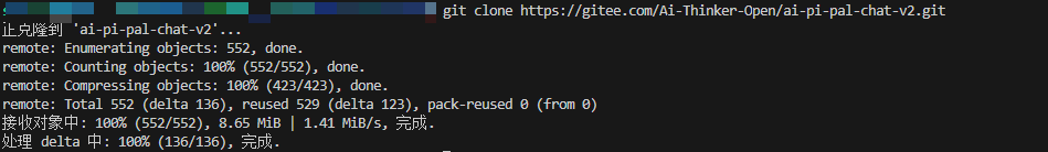

▫️克隆仓库
shell
git clone https://gitee.com/Ai-Thinker-Open/aipi-palchat_v2.git
(点击查看) 克隆完成实例

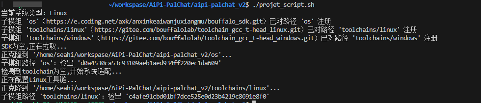

  • 运行脚本
shell
./projet_script.sh
运行这个指令之后,需要等待克隆完成!
(点击查看) 成功实例

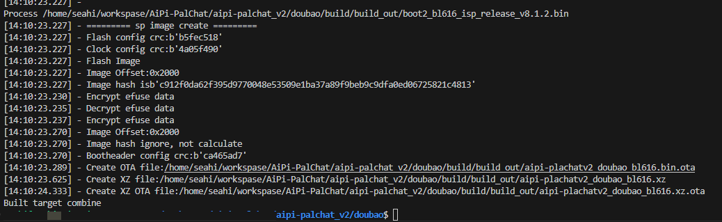

(点击查看) 编译完成示例
alt text

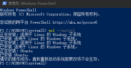

2. Windows 平台
使用 以管理员身份运行 PowerShell。在 PowerShell 下方指令安装Linux 子系统:
shell
wsl --install
(点击查看) 安装完成示例
alt text

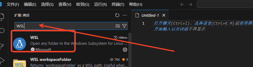

▫️VSCode 安装WSL 集成
在VSCode 集成中搜索 WSL,并且安装:
alt text

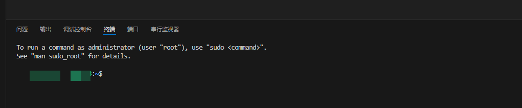

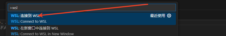

▫️VSCode 打开WSL
在VSCode 的搜索栏输入:>WSL 选择 WSL:连接到WSL
alt text
在首次连接WSL时,会下载 VSCode 服务器,要保持电脑网路正常。
(点击查看) 连接成功示例
alt text

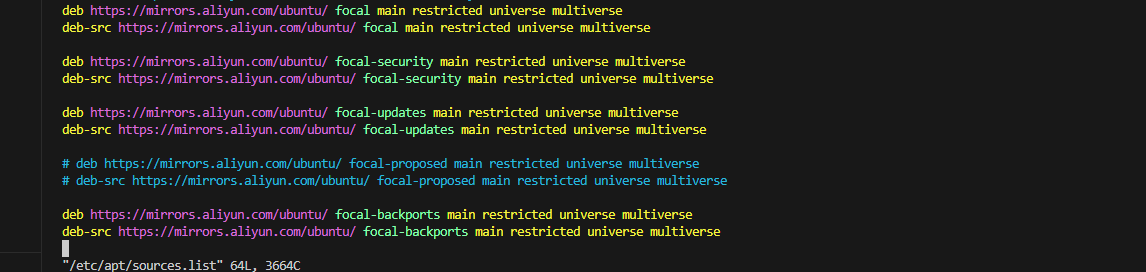

▫️更换软件源
  • 用终端使用下方指令:
shell
sudo vi /etc/apt/sources.list
  • 把内容全部替换为下方的源地址:
清华源 (Ubuntu20.04)

阿里源 (Ubuntu20.04)
shell
deb https://mirrors.aliyun.com/ubuntu/ focal main restricted universe multiverse
deb-src https://mirrors.aliyun.com/ubuntu/ focal main restricted universe multiverse
deb https://mirrors.aliyun.com/ubuntu/ focal-security main restricted universe multiverse
deb-src https://mirrors.aliyun.com/ubuntu/ focal-security main restricted universe multiverse
deb https://mirrors.aliyun.com/ubuntu/ focal-updates main restricted universe multiverse
deb-src https://mirrors.aliyun.com/ubuntu/ focal-updates main restricted universe multiverse
# deb https://mirrors.aliyun.com/ubuntu/ focal-proposed main restricted universe multiverse
# deb-src https://mirrors.aliyun.com/ubuntu/ focal-proposed main restricted universe multiverse
deb https://mirrors.aliyun.com/ubuntu/ focal-backports main restricted universe multiverse
deb-src https://mirrors.aliyun.com/ubuntu/ focal-backports main restricted universe multiverse
中科大源 (Ubuntu20.04)
shell
# 默认注释了源码仓库,如有需要可自行取消注释
deb https://mirrors.ustc.edu.cn/ubuntu/ focal main restricted universe multiverse
# deb-src https://mirrors.ustc.edu.cn/ubuntu/ focal main restricted universe multiverse
deb https://mirrors.ustc.edu.cn/ubuntu/ focal-security main restricted universe multiverse
# deb-src https://mirrors.ustc.edu.cn/ubuntu/ focal-security main restricted universe multiverse
deb https://mirrors.ustc.edu.cn/ubuntu/ focal-updates main restricted universe multiverse
# deb-src https://mirrors.ustc.edu.cn/ubuntu/ focal-updates main restricted universe multiverse
deb https://mirrors.ustc.edu.cn/ubuntu/ focal-backports main restricted universe multiverse
# deb-src https://mirrors.ustc.edu.cn/ubuntu/ focal-backports main restricted universe multiverse
示例:
alt text
